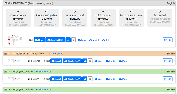

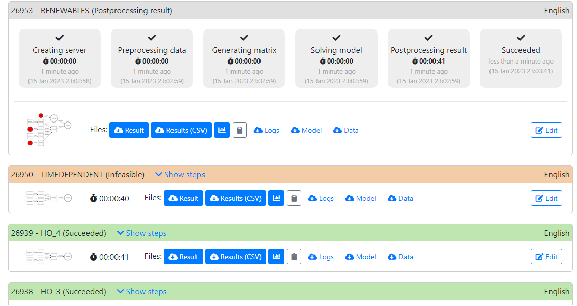

Dear Moses,
From your screen shot- you are missing the the technologies MINSOL MINWND and MINHYD - the error is highlighted in RED, click on the model picture after you do a run to see your model structure clearly

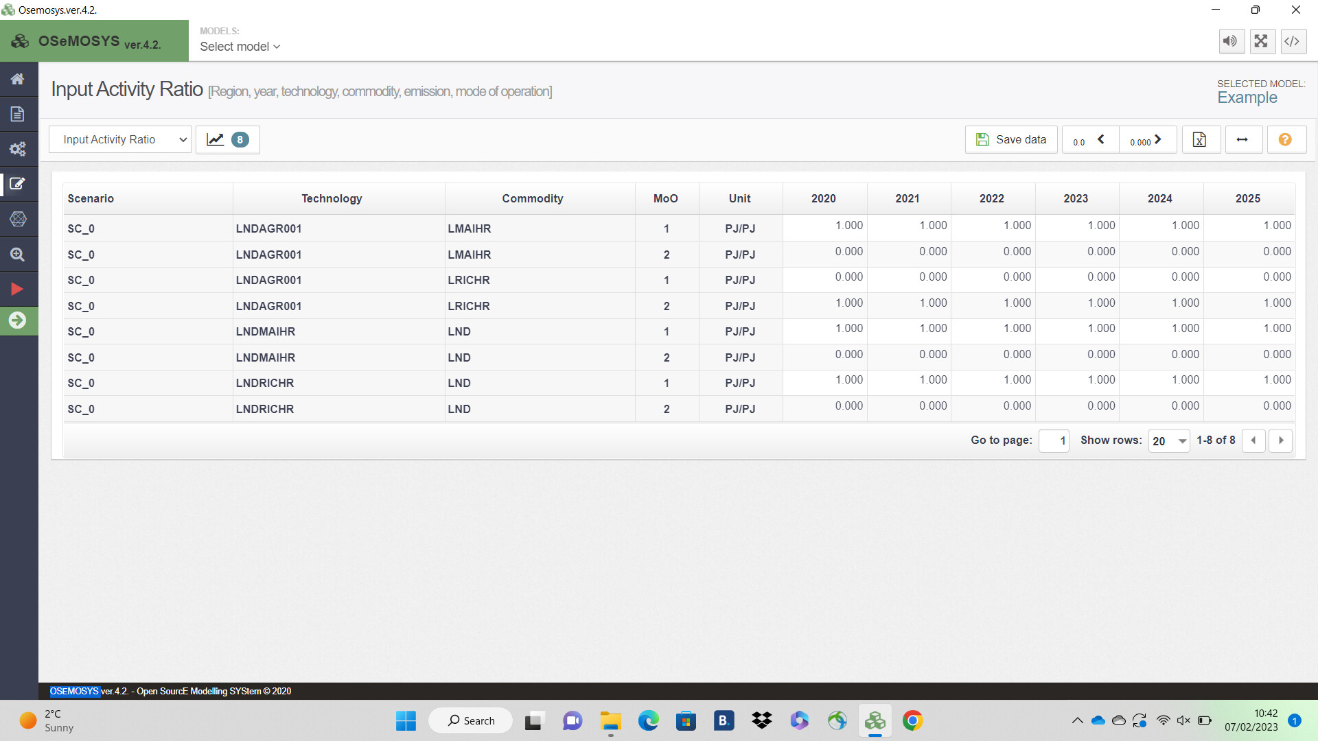

Thanks for your assistance. I have made the correction and obtained the results as can be seen attached. My issue now on HO6 is on the mode of operation as I am finding it difficult to navigate between one and two. I have changed the number from 1 to 2 but it I cannot see what is mode one and two. Please help. Thanks.

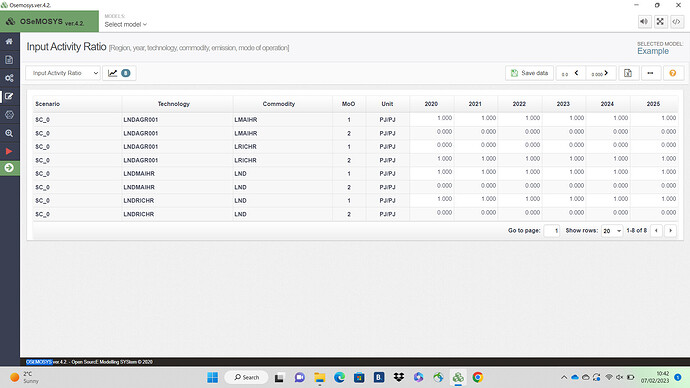

Hi Moses,
Sorry for the delay in this response, I from CCG had been away in Costa Rica for an energy modelling platform for Latin America with many other team members.
In regards to your query. When you set the modes of operation to 2 (or more numbers) it should appear like the image below when you view the data entry tab (e.g. Input Activity Ratio). So in the case of the table attached (from HO6), LMAIHR is mode 1 and LRICHR is mode 2.
(Note: you will have more techs/commodities in your model by now, i have just created the image to show how it should look).
Important to remember: the ‘default’ mode of operation is 1. The further mode of operations largely links to the technology LNDAGR001.
(This is something we look to change in the future, as it is more necessary for larger models).
