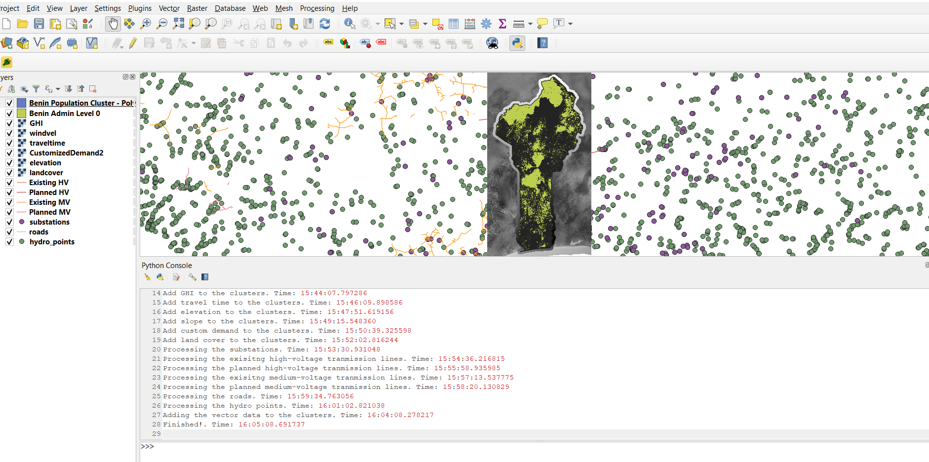

This works very well with this version of QGIS as shown below. Many thanks.
Uduak
