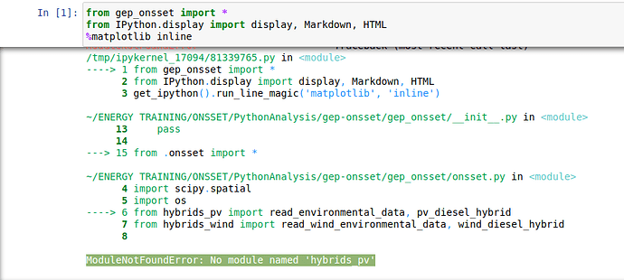

Hi I’m getting this error when running the jupyter notebook:
See attached
Hi!
Thank you for reaching out. Can you please send a screenshot of the OnSSET folder where you have the notebook?
I think perhaps there is a problem there.

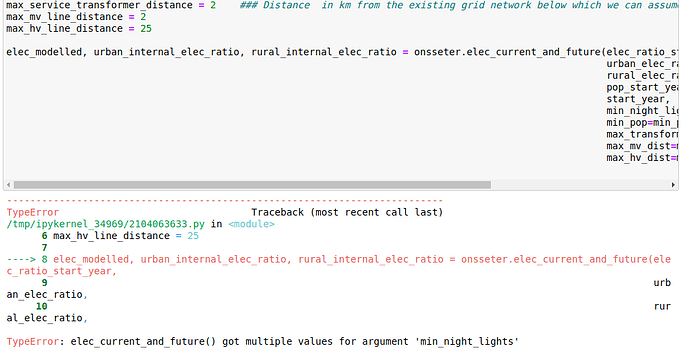

However, It runs smoothly till section 6, where I get the following errors
Are you currently running the course at open university?
If so, please follow the instruction given in hands-on 6 document. It looks like you perhaps have the wrong version of the code.

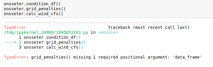

Hi Mr Khavari,
I am currently taking the ONSSET course on the Open University platform. I am experiencing the same problem as highlighted here the error message when running onsset in the jupyter notebook for hands on exercise 6. I tried changing the version of the code to 2022 but I keep getting the same error.
Thank you.
Hi Olivia,
Sorry to hear that your are running into problems with the code.
Can you send a screenshot of the error here together with information on what stage this error occurred at?
