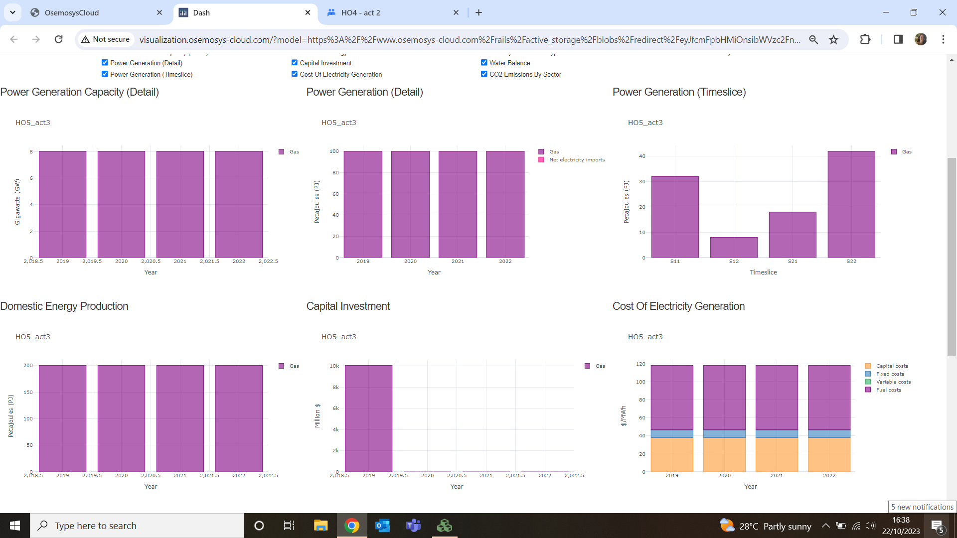

On the Hands On 4 modelling exercise, I have inserted all parameters as specified in the guide. However, when running the model it still gives me gas as the fuel of choice for optimisation. I have re-checked many times and couldn’t find any mistake that could justify why I am not seeing Coal instead.
Does anyone have any idea of what could be happening?

I have run HO5-act 3 and coal is definitely not appearing as an option in the Run results. I have re-checked each data entry, and they are correct. Still, this is what I see:
I thought the model may not be reading Coal is a component, but it is accepted there in Commodities sets. What am I missing?

There should be a mix of coal and gas for HO5, so I can try and help to find the issue! Could you please tell me your country and the run number it states on the cloud? I can then check the data file just to make sure that all inputted data is correct :slight_smile:

Thank you very much! I have found where the mistake was: the OutputActivityRatio for PWRCOA hadn’t saved correctly, so it had a ratio 0, compared to all other technologies that had ratio 1.
